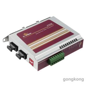

艾讯科技FT5702串口服务器
艾讯科技FT5702串口服务器
2015/9/17 21:21:30
产品简介:
产品分类:
工业以太网
品牌:
艾讯科技
产品介绍
产品特点:
Supports 2 ports configurable RS-232/422/485
Provides Self-Healing Ring feature to prevent network interruption
Offers single-mode and multi-mode and SC, ST, WDM fiber optic options for both LAN ports
Equipped two terminal block power inputs ensure the continuous electrical stability
Supports DNP3.0 protocol transparency
Aluminum housing with Panel and DIN-Rail mounting brings more installation flexibility
64KB port buffer prevents data loss when temporally connection fails
Informs user by relay output in case of any disconnection
Simple Master/Local Configuration by DIP switch selection
订购信息:
FT5702-2XT 2-port RS-232/422/485 Self-Healing Ring Fiber Modem with 2-port 100BASE-FX
