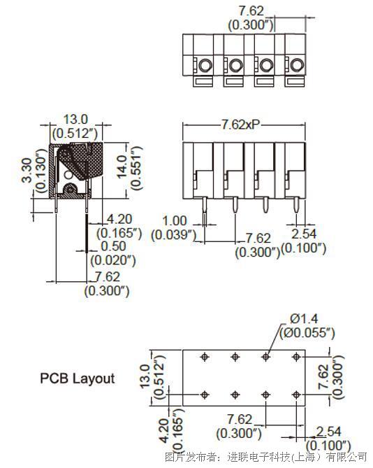

MX122-508 PCB 弹片型端子连接器
DIMENSIONS/POSITIONS
MX122-508
間距Pitch
5.08mm
位數Poles
2 ~ 24Poles
塑膠本體Housing Material
PA 66
端蓋Cover
PA 66
端子Contact
Brass, Tin Plated
彈片Spring
Stainless Strip Steel
電線線徑Wire Size
14 ~ 24AWG
剝線長度Wire Strip Length
10mm
PCB孔徑PCB  Hole Diameter
1.4mm
環境作業溫度Operating Temperature
-40˚C to  +105˚C
TECHNICAL DATA
連接符合標準
Connection  in acc. with standard EN-VDE
額定電流 lN Nominal Current lN
10A
額定橫截面Nominal Cross Section
2.5mm2
最大負載電流Maximum load current
16A
絕緣材料Insulating Material
PA
阻燃等級,符合UL94
Inflammability class acc.  to UL94
V0
額定電壓,UL/CUL
Nominal voltage, UL/CUL
300V
額定電流,UL/CUL
Nominal current, UL/CUL
10A
产品介绍
MX122-762 PCB 弹片型端子连接器
MX122-762
間距Pitch
7.62mm
位數Poles
2 ~ 16Poles
PA 66
端蓋Cover
PA 66
端子Contact
Brass, Tin Plated
彈片Spring
電線線徑Wire Size
14 ~ 24AWG
10mm
1.4mm
-40˚C to  +105˚C
TECHNICAL DATA
連接符合標準
10A
2.5mm2
16A
PA
阻燃等級,符合UL94
V0
額定電壓,UL/CUL
300V
額定電流,UL/CUL
10A
