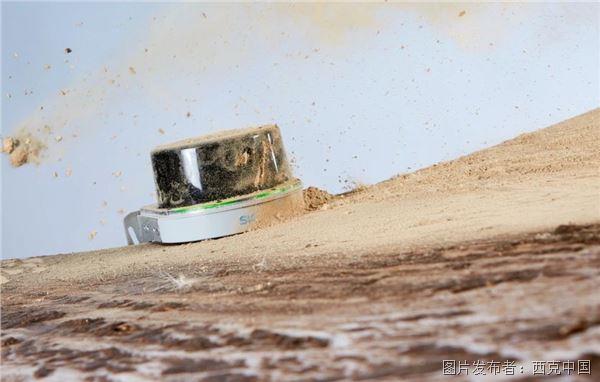

77700b7604f001bb6a8d65ae1da18bef.jpgMRS1000 激光扫描仪传感器
