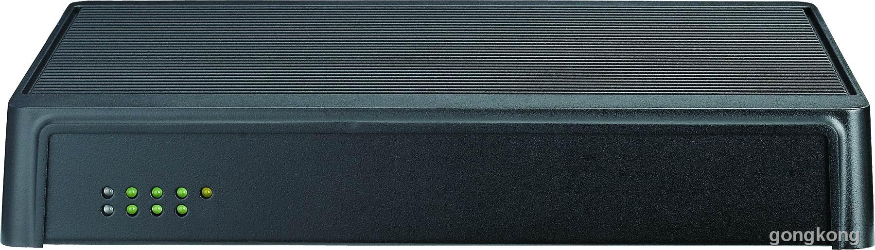

产品简介:
桌上型网络安全平台 Intel® Atom? D525 Dual Core/ D425 Single Core 1.8GHz 处理器 板载2GB DDR3/800 内存,1个可达4GB DDR3/800 SO-DIMM 插槽 6 x Intel 82583V 千兆网接口 支持 LAN Bypass 内置1个 2.5” HDD Bay/ 1个 SATA DOM (可选) 无风扇设计

Support Intel® Atom? D525 Dual Core/ D425 Single Core 1.8GHz Processor
Intel® ICH8M Chipset
内存
Onboard 2GB DDR3 800 Memory (Default) 1 x 204-pin DDR3 800 SO-DIMM Socket, up to 4GB Non-ECC SDRAM
网络
LAN Chip: Intel® 82583V
Support 10/100/1000 link speed
LAN Bypass: 1 pairs
扩展
1 x Mini-PCIe Slot, co-lay with LAN ETH0
I/O 接口-前面板
Power status/LAN status/Bypass status LED
I/O 接口-后面板
1 x Power Jack connector
1 x software button
1 x RJ45 type Console Port 2
 x USB 2.0 Ports
6 x Copper LAN Port
2 x holes for Wireless Antenna
存储设置
1 x CompactFlash Socket (Optional)
1 x 2.5" HDD bay
1 x SATA-DOM device space
电源输入
40W Power Adapter
机箱尺寸
Chassis Dimension: 250mm x 194mm x 40mm
Carton Dimension: 430mm x 300mm x 170mm
重量
Without Packing: 2kg
With Packing: 3.3kg
通过认证
CE approval
FCC Class A
